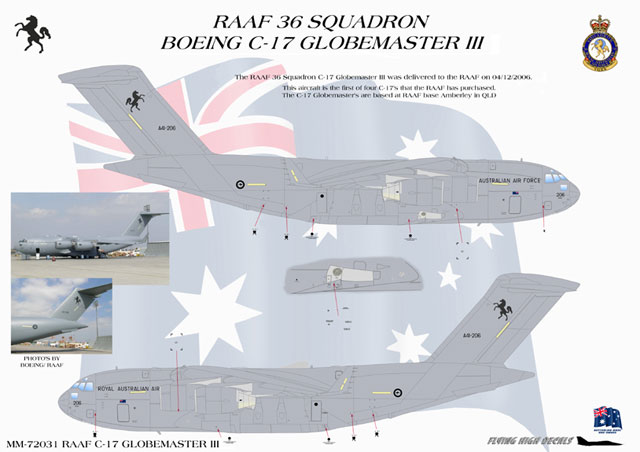

Griff13 Posted April 17, 2007 Share Posted April 17, 2007 Looking amazing EF!! What makings are you going to use? Are you going to still use the Charleston ones? Quote Link to post Share on other sites
EF Posted April 17, 2007 Author Share Posted April 17, 2007 (edited) Not sure, probably the RAAF decals made by Steve Evans Down Under. Edited April 17, 2007 by EF Quote Link to post Share on other sites

Nev Posted April 21, 2007 Share Posted April 21, 2007 Great work so far Efrain. As for markings.... *chants* RAF! RAF! RAF! RAF! RAF! Quote Link to post Share on other sites
Bullet101 Posted April 21, 2007 Share Posted April 21, 2007 Great work as usual mate, gotta go with Nev on this one though, RAF all the way! Quote Link to post Share on other sites
