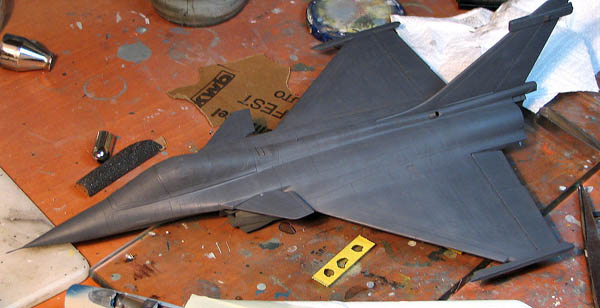

Kaan Posted June 21, 2006 Share Posted June 21, 2006 Here is what I did for my Rafale C. I filled the airbrush with slightly "lighter" black, thinned it, and did horizontal small streaks to the whole airframe. Quote Link to post Share on other sites
