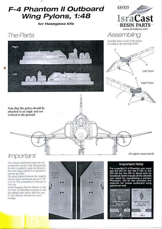

Julien (UK) Posted April 3, 2008 Share Posted April 3, 2008 Not standard mounts as in the picture but exactly same mounts as on the tanks but seperate. You get these in 1.72 in the fujimi kits, and in 1.48 are made by Isracast; http://www.hannants.co.uk/search/?FULL=ISC48005 These are the ones I am using for my "chico" Julien Quote Link to post Share on other sites
Harold Posted April 3, 2008 Author Share Posted April 3, 2008 Julien (UK) said: Not standard mounts as in the picture but exactly same mounts as on the tanks but seperate.You get these in 1.72 in the fujimi kits, and in 1.48 are made by Isracast; http://www.hannants.co.uk/search/?FULL=ISC48005 These are the ones I am using for my "chico" Julien Thanks Julien, That's the kind of info I need to do things right. Harold Quote Link to post Share on other sites

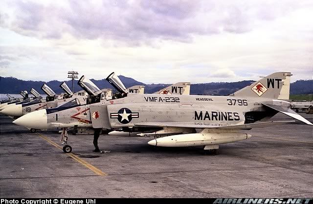

Gene K Posted April 3, 2008 Share Posted April 3, 2008 Harold said: Thanks Julien,That's the kind of info I need to do things right. Harold Except that's not exactly right. The 1/72 Fujimi kits have the Navy outboard pylons (with the "angled" adapters) - Chico was an Air Force airplane (DUH), so you need the AF pylons as explained by Dave. Isracast has AF pylons in 1/48, as does the old KMC (True Details) and AirDoc. In 1/32, I think the way to get AF pylons is as Dave suggested - flatten the Navy. In a pinch, you could fashion a set by separating the tanks from their pylons, but you'd have to add plastic where the tank curves, even up the rear, and scribe. Next can of worms would be the angle of the outboard pylons..... Gene K Quote Link to post Share on other sites

f4h1phantom Posted April 4, 2008 Share Posted April 4, 2008 Those Isracast pylons look gorgeous! They even include handed sway braces. Wish a better pic of the two pylons were included to see if they cattered for the canting. Thanks for the link, Julien. Jorge. Quote Link to post Share on other sites
Gene K Posted April 4, 2008 Share Posted April 4, 2008 (edited) f4h1phantom said: Wish a better pic of the two pylons were included to see if they cattered for the canting. This addresses handed and canted: Gene K Edited April 4, 2008 by Gene K Quote Link to post Share on other sites

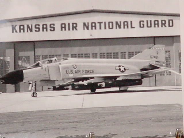

silverkite211 Posted April 4, 2008 Share Posted April 4, 2008 I don't have a scanner, so I had to take a photo of a photo. At least you can see that the gun pod mounts flush to the bottom of the pylon. Quote Link to post Share on other sites

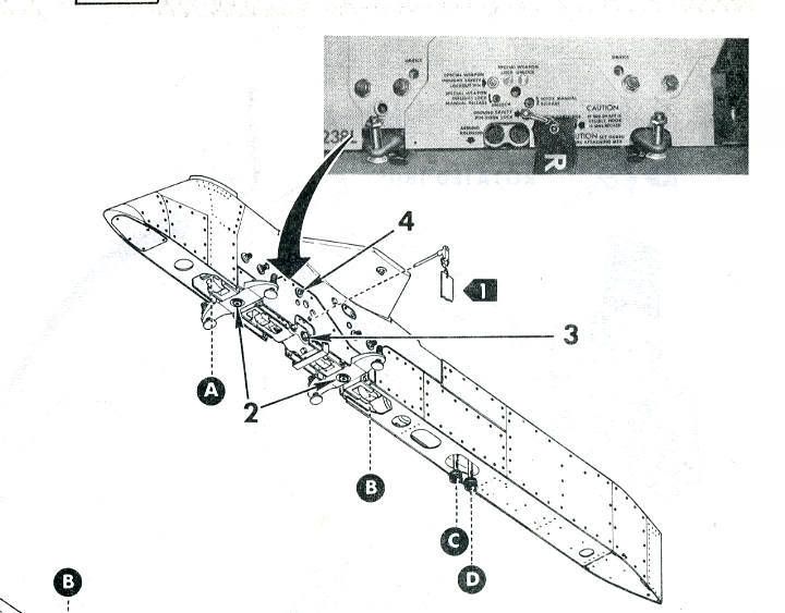

Harold Posted April 4, 2008 Author Share Posted April 4, 2008 Rusty Shackleford said: Go here: Chico's StoryNote the picture with the gunpod on Sta 1. It is canted outboard. The pylon is designed this way. The pylon is mounted to the wing via a forward and aft screw. There are nuts on both the aft section of the pylon and a bigger one on the forward section, underneath a removable panel. The wing-like extensions on either side of the pylon are fixed in place and are what cant the pylon outward. The forward attach point on the wing pivots slightly to allow the pylon to be tightened then torqued and safety-wired in place. The rack inside is a MAU-12A, same as what's on Stas. 2 and 8 but NOT the centerline, as previously mentioned. In order to sway the SUU-23 down, the inboards were run down to push the pod outward. Then, they were simultaneously tightened a half turn at a time, twice. As has been said, not a very common loadout and harmonizing the guns was the most fun part, which I never got to do. Gunshop would do that. Back in the good ol' days of MMS. (Munitions Maintenance Squadron) Thanks all... I may get the 1/48 set and upscale it for the gunfighters gun pods. Quote Link to post Share on other sites
Harold Posted April 4, 2008 Author Share Posted April 4, 2008 silverkite211 said: I don't have a scanner, so I had to take a photo of a photo. At least you can see that the gun pod mounts flush to the bottom of the pylon. It is also using the "stubby" rear.... Quote Link to post Share on other sites
silverkite211 Posted April 4, 2008 Share Posted April 4, 2008 The feeling that I got, from speaking to people who were/are members of the KANG is that the rear cones were just sort of a nuisance, they weren't really needed on the gun pod, they just got in the way so they were left off. I've noticed in photos that the RAF didn't seem to use them much on their FGR.2s, either, though that has nothing to do with 'Chico', of course. Quote Link to post Share on other sites
Harold Posted April 4, 2008 Author Share Posted April 4, 2008 Gene K said: Harold,Not sure what you mean by the "standard SUU-23 pylon"......but...the gun mounts to the centerline ejector rack (in the fuselage) via the Aero-27/A Bomb Rack Adapter (the same adapter that holds the MER). This adapter is unique to the centerline On the outboard stations, the gun mounts directly to (the ejector rack inside) the pylon. Note that in the table, the "Tank Pylon and Adapter" listed for the outboard stations refers to the early McD tank pylon that was wired (early tank was separate from the pylon). Gene K It also appears that the SUU 16 didn't have the large vents on the side. I haven't found really good shots of that version. The only photos I have found, has the panel romoved. Quote Link to post Share on other sites

Gene K Posted April 7, 2008 Share Posted April 7, 2008 Great info, Rusty, thanks. Could you clarify a little, please: Rusty Shackleford said: The wing-like extensions on either side of the pylon are fixed in place and are what cant the pylon outward. So the those extensions are "fixed in place" on the pylon, making them handed (as opposed to being fixed to the wing)? What I'm asking is whether the extensions were handed and could be attached to a pylon , thus making the assembly handed? Quote The rack inside is a MAU-12A, same as what's on Stas. 2 and 8 but NOT the centerline, as previously mentioned. If you're referring to my post above, I said the Aero-27A bomb rack adapter was unique to the centerline. "Of course" it attaches to the Aero-27/A Ejector Rack, not a MAU-12 ejector rack. Quote In order to sway the SUU-23 down, the inboards were run down to push the pod outward. So there should be a space under the inboard wing extension? Was this pylon canting done for all configurations/models? I assume we're talking AF acft, and in that regard, per my limited carriage charts, looks like AF Phantoms (unlike the Navy) were not certified/authorized to carry TERs on the outboard pylons (but I have seen a rare picture of a TER on an AF outboard station) - any idea why the services differed on the station loading? Appreciate the info. Gene K Quote Link to post Share on other sites
