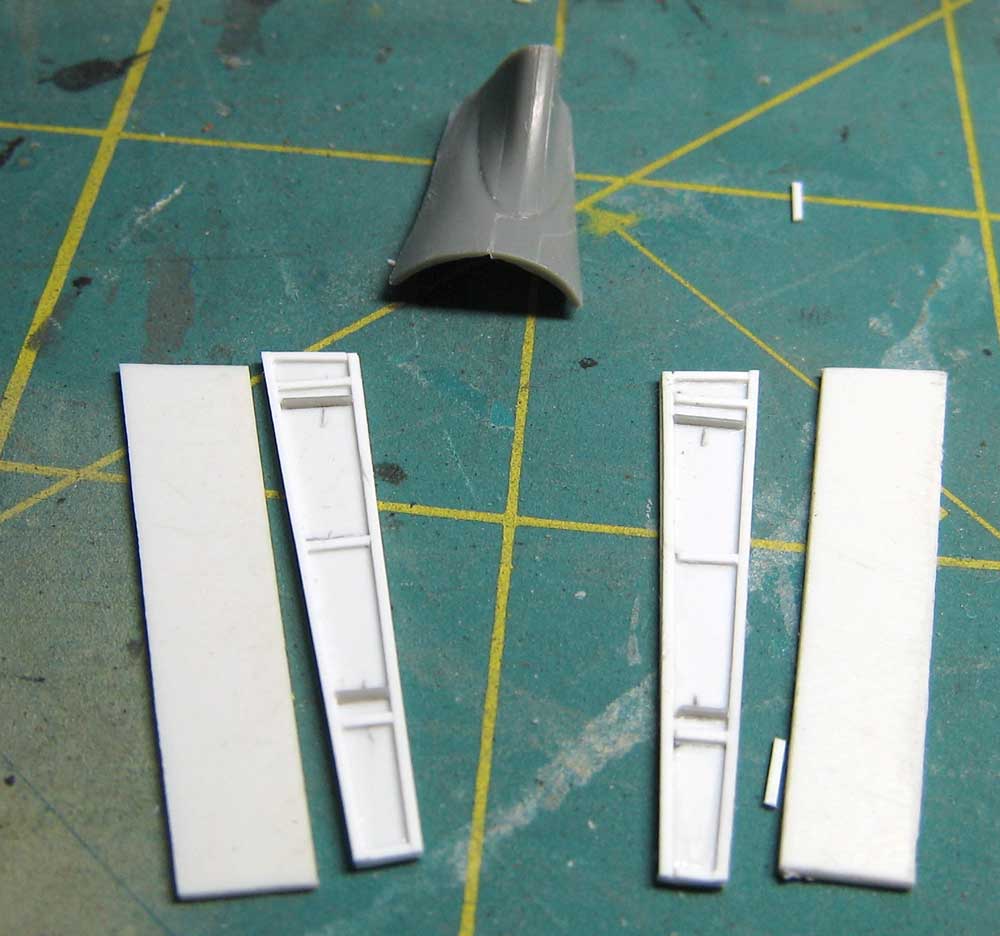

Here are the new folding panels, from styrene, stretched sprue and Evergreen strip, plus the tail fillet. Note the rudder offset- that's not making fitting the bulkhead any easier!
Here's a detail short- this is one of the second set of upper panels. The first set was ruined when I tried give them a mild bend using hot water to better match the ones cut from the kit. Careful examination of photos of the rear turtledeck doesn't really show any curvature. I think I'll leave 'em flat.

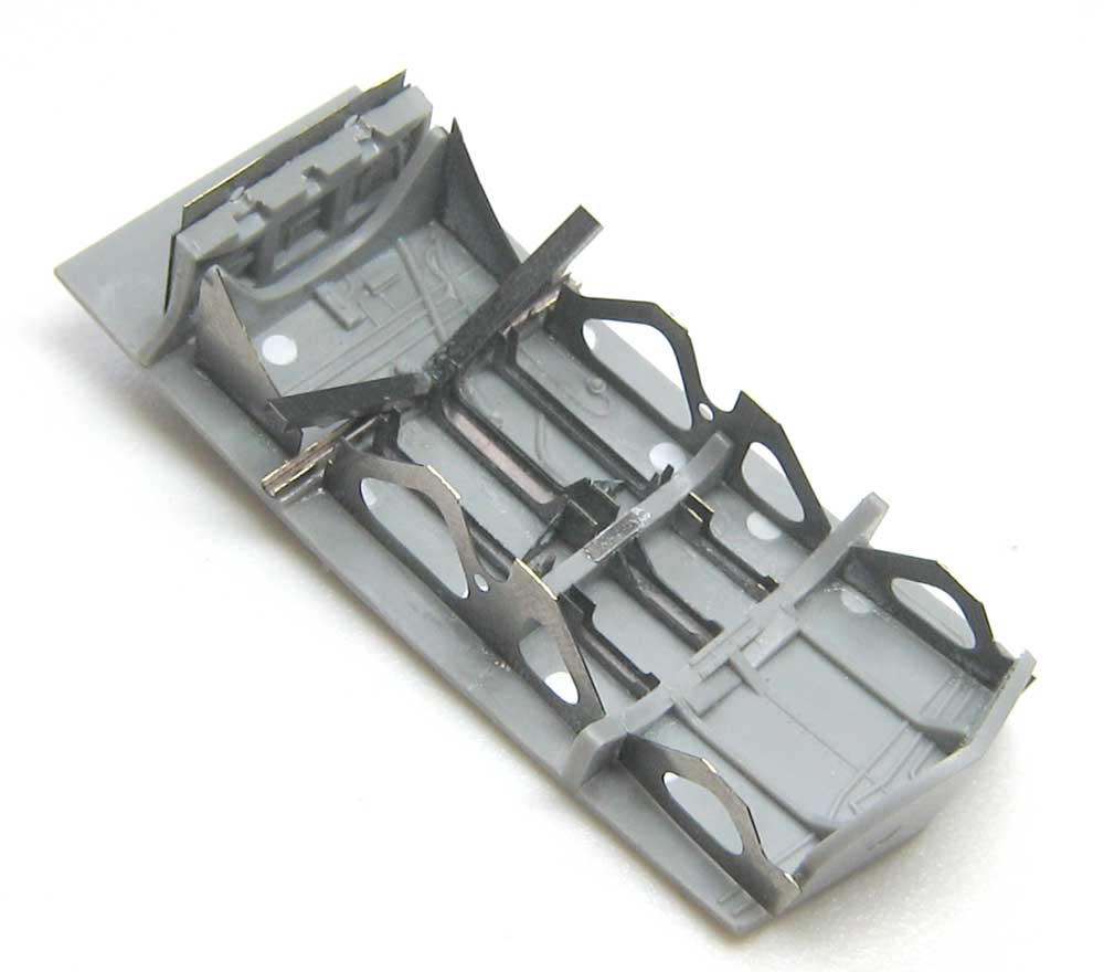

I managed to sneak a bit of modeling time in- I laid the photo-etch in the bomb bay- starting to look busy! The fit of all the little widgets is excellent- good job, Uncle Eduard!
The trusses sport some excellent detail.
Uh-oh! Lots of CYA "frost"- not to worry- this will disappear under a coat of primer. Lots of plumbing to be added as well!

Back from my journeys- and back to that bomb bay! Here's an alert- one thing the good folks at Eduard fail to mention is this little stub spar in the wing root. Chop it out or the PE-enhanced bay won't fit!
Here's what it should look like- easy!
