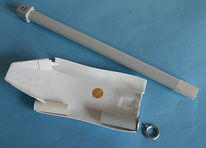

Flankerman Posted February 27, 2008 Share Posted February 27, 2008 (edited) Well, I have made a start on this beast - it looks like it may be quite a job It is Contrail quality - the shape is good, but the plastic is a bit crude in places. See:- http://www.flankers-site.co.uk/modl_be-10.html for the boxart and kit parts. The plastic is very thick - about 2mm - which makes it difficult to cut out from the backing sheet, but it does give it some strength. I have cut out most of the parts - and hacked away at the 2mm 'lip' around the edges. The wings took a lot of scraping at the trailing edge to get a thin section. My starting point is the wing centre section/engine nacelles - they are complex shapes and are moulded in upper and lower halves. Fitting the upper & lower parts together is not helped by the fact that the thickness of the plastic is different - so the mating edges are thick to thin - adding thin plastic tabs is not easy Deka provide the interior jetpipes as half-round sections that are supposed to be glued together to form tubes....... They also provide a crude white-metal intake lip - plus an etched-brass fan blade - I decided to replace them with intakes made from a hollow 15mm dia plastic knitting needle and jetpipes from a suitable diameter section of plastic tube..... The area of the fuselage around the jetpipes is a complex 'pen knib' fairing - and Deka's moulding does not extend far enough into the jetpipe area - so I have added bits of plastic card to make it good. It is all a bit crude at the moment - I am making it up as I go along....... Ken Edited February 27, 2008 by Flankerman Quote Link to post Share on other sites

Flankerman Posted February 27, 2008 Author Share Posted February 27, 2008 Good idea on the knitting needle - never thought of that. Now if my girlfriend find me pinching her knitting needles, there'll be Hell to pay...Jens I discovered them a few years ago when I started making scratch-built 1:700 scale subs - they make an ideal starting point for the hull. Up to about 12mm they are solid - ideal for drop tanks, sub hulls etc. I had hoped that the 15mm dia ones were also solid (for some modern US subs) - but after I bought them, I discovered they were hollow. Still - hollow 15mm dia tubing always comes in handy ! Ken Quote Link to post Share on other sites

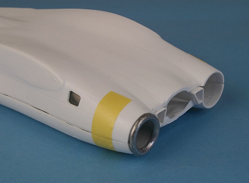

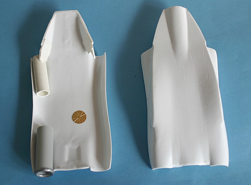

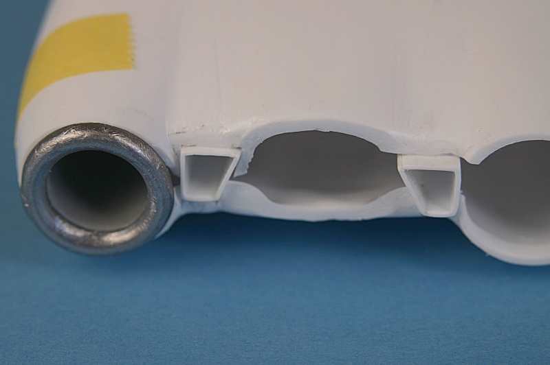

Flankerman Posted February 28, 2008 Author Share Posted February 28, 2008 Some more progress...... Here is the wing centre section temporarily taped together to show the complex shape...... The drawings in the excellent Ukrainian magazine Aviatsiya i Vremya plus photos, show that there are two large openings on the outside of the engine intakes. I have cut them out and backed them with spare etched mesh. The white metal intake lip and intake tube are also temporarily installed... The drawings also show another intake between the fuselage and the jet intakes - I have also added these - to be sanded and blended in later.... The area around the jetpipes also needs some work - the opening above the jetpipe has yet to be filled - and blended into a smooth curve into the pen-knib plate on the fuselage..... More soon........ Ken Quote Link to post Share on other sites

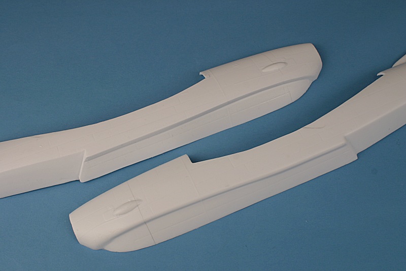

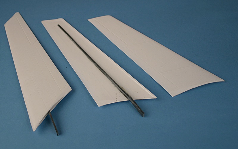

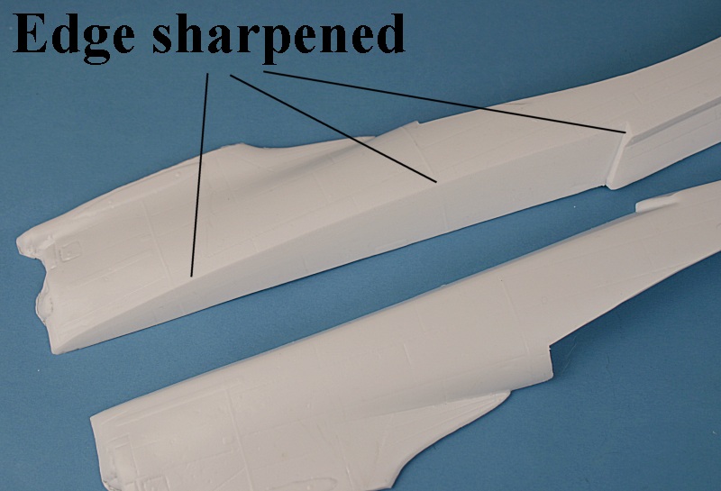

Flankerman Posted February 28, 2008 Author Share Posted February 28, 2008 Meanwhile, back at the wings....... Cut out, edges scraped to as thin a section as I can manage, spars added, cemented together (at left)..... ...trouble is it is a gull wing - except that the 'gull' join is at the fuselage centre section. There is a massive shoulder on the centre section - and the wings are joined at the gull break - with massive dihedral to be incorporated. It is going to be difficult to get a smooth join - the wing/fuselage junction on the underside is right up under the engine nacelles, where you can't get at it, the join on the top is easier to access for sanding - but it is very visible. On the fuselage, due to the limitations of vacforming, the detail is very 'soft' - especially so at the edges where the vertical fuselage side meets the vee planing bottom. Fortunately the plastic is thick enough to allow for lots of scraping & sanding to get a sharp edge..... This shot shows the scraped and sharpened forward chine on the fuselage half at the top - the original rounded moulding is at the bottom..... Ken Quote Link to post Share on other sites

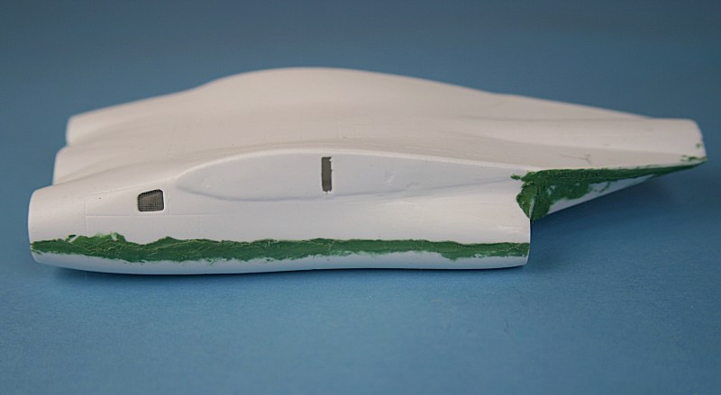

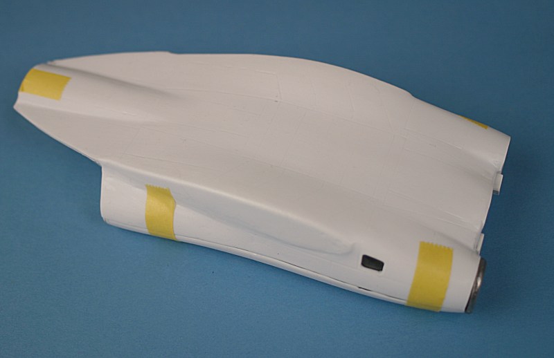

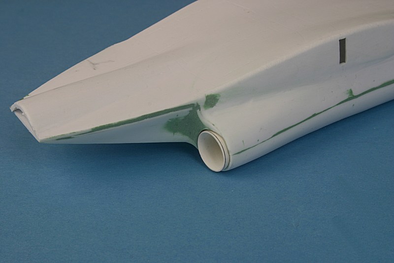

Flankerman Posted March 2, 2008 Author Share Posted March 2, 2008 (edited) Onward and upward....... The centre section has been joined and the joints filled with Green Stuff.... ....the biggest problem is blending in the jetpipe into the surrounding 'pen knib' fairing... ....but once filled and smoothed, it is begining to look OK. This is the starboard side - with the plastic tubing jetpipe temporarily in place - I have left it removablae to aid painting later. Ken Edited March 2, 2008 by Flankerman Quote Link to post Share on other sites

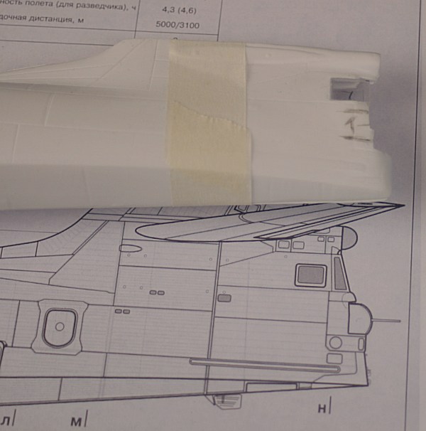

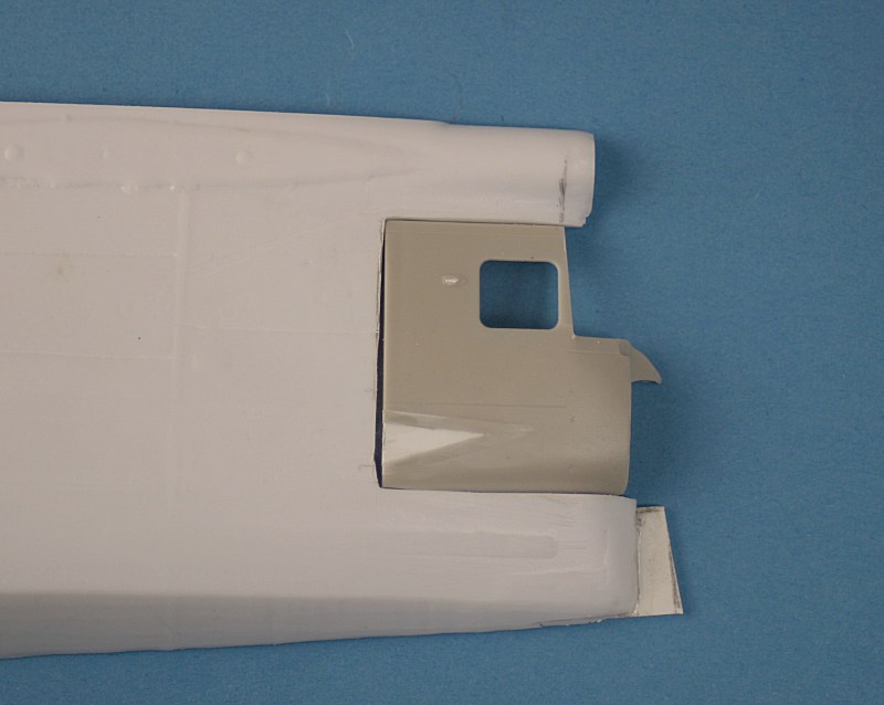

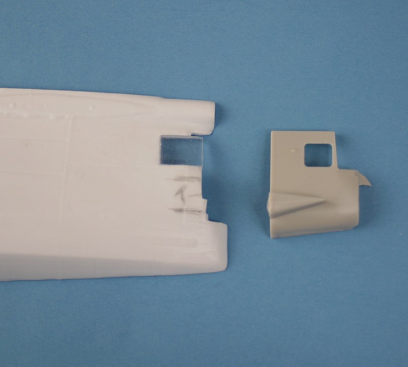

Flankerman Posted March 2, 2008 Author Share Posted March 2, 2008 Another area that needs fixing is the rear end - with its gun turret. The extreme bottom tip on the kit is too blunt - it needs to be extended and sharpened to a knife-edge. Deka provide vacform 'windows for the gunners station - and a white metal 'ball' turret - but the whole thing is a bit 'vague' and poorly formed. I made a start and cut out the area and added side windows from thick clear plastic..... ....the drawings are from Aviatsiya i Vremya BTW - available to download here. I was faced with a difficult task to get the rear end right - when my pal Jon suggested using the rear turret assembly from the Roden injection-moulded kit of the Antonov An-12BK-PPS kit.... The gunner's station is surplus to requirements in the -PPS version - so a quick sort through the stash found the kit and part.... ... and guess what ?? it fits OK - thank goodness to Soviet standardisation! I'll have to remove the tailplane roots moulded into the Roden parts - but it looks do-able. All I have to do now is graft it into place... Ken Quote Link to post Share on other sites
Flankerman Posted March 2, 2008 Author Share Posted March 2, 2008 Guess what - it works!! Thanks Jonathan :) Ken Quote Link to post Share on other sites

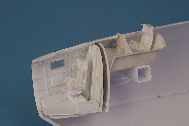

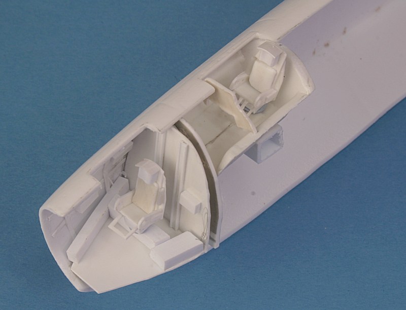

Flankerman Posted March 3, 2008 Author Share Posted March 3, 2008 (edited) Deka only provide a rudimentary vacformed 'tub' for the pilot's cockpit - plus an instrument panel. Floor and bulkheads are provided for the navigators position - but they don't fit very well! I have scratchbuilt the navigator's station - with a new floor, rear bulkhead, some internal structure and a few 'boxes'. Also scratched are the navigator's and pilot's ejection seats - nothing is provided in the kit...... I'll probably add a bit more detail - all purely guesswork - to 'busy' up the area. The pilot's cockpit also needs some more work - instruments from the decals stash, control column, throttles etc. I want to have the nav's hatch open - and, possibly, the canopy - hence the detail work. It isn't Haneto-standard - but in this scale, it'll do for me........ Ken Edited March 3, 2008 by Flankerman Quote Link to post Share on other sites
