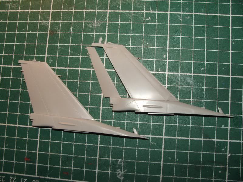

maurizio Posted November 10, 2008 Author Share Posted November 10, 2008 I made the rivets on the tail during the week end together starting polishing the canopies. Rivets on the fin are very light but they are present!!! cheeers Maurizio Quote Link to post Share on other sites
