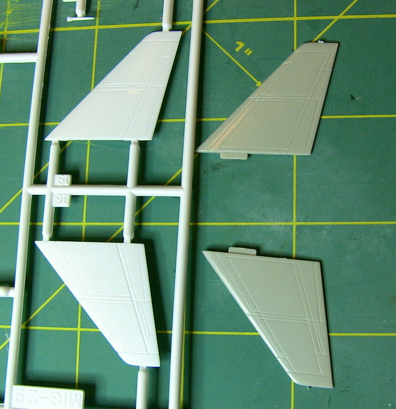

FlyingLow Posted January 11, 2009 Author Share Posted January 11, 2009 The first step was to scratch build the wings and horizontal stabilizers. I only had 0.5 mm (0.20") styren so I had to laminate it. Four layers for wings and two for stabilizers. While that was drying I cut the mask: and outlined the wings: After some cuting and rough sanding the shape was ready. I am of course not 100% relying on blueprints but am also comparing to photos: Another one: Quote Link to post Share on other sites

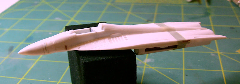

FlyingLow Posted January 12, 2009 Author Share Posted January 12, 2009 Thanks for the encouragement. So far it went pretty fast but I expect slowdown now that I am starting with all small details and precise sanding, scribings, etc. During the Weekend I was able to stretch bottom part of the fuselage, Iscratch built the wheel wells (both models have just hole into the whole fuselage), I was able to fit the cockpit floor from Academy kit into Revell, and at last glued both parts of fuselage together. Fit is OK, just couple of small seams that were filled with pieces of styren and liquid putty. The last major part of construction was adding nose to the fuselage, I think now it is finally starting to look like a MiG. Fit is pretty good, just some minor puttying and blending in still needs to be done and the basic shape will be finished. Couple of photos: After those pictures were taken I already engraved the stabilizers and did some more sanding. Quote Link to post Share on other sites

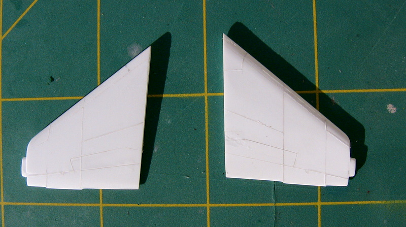

FlyingLow Posted January 17, 2009 Author Share Posted January 17, 2009 It was pretty busy week at work but I was still able to make some progress . Next step was pretty simple, both Academy and Revell have rounded sections on sides from cockpit, simple straightening and thinning by sanding is enough, the picture below shows how it should be: I first tested panel engraving on horizontal stabilizers and after a light coat of Mr. Surfacer I got pretty good idea how the rest of engraving will go. I used the smallest pin I could find. Because the pin actually pushes plastic to sides and does not remove material it requires few repeats of sanding and cleaning the grooves. I have at least one more sanding to do. I had some problems on the wings. It seems that layers of styren didn't bond too well so when cuting the panels the layers separated in couple of places. But nothing some CA and sanding couldn't fix. Current state of the fuselage from top: And bottom: Air intakes are built from scratch, glued to the model and roughly sanded. Some more sanding and blending in si required but they already look better than original ones from the kit. ChristoperC, no there are no special tricks just careful sanding. To achieve flat surface I started with rough sandpaper on a piece of glass and then finished it of with several grades of sanding sticks. I had some problems engraving on main wings but generally pretty smooth sailing so far. Quote Link to post Share on other sites
