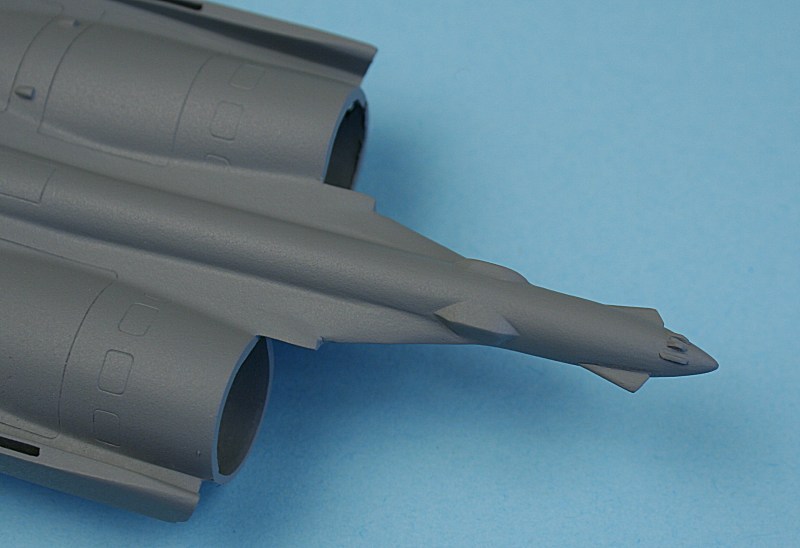

Flankerman Posted April 9, 2009 Share Posted April 9, 2009 (edited) OK - I've made a start...... Take one Airfix Su-27.... add large MFD screens to the cockpit..... I'm not bothered about too much detail as the canopy will be closed. I have added plastic card to raise the windscreen (it looks better), added the platform for the offset IRST ball and made a recess for the IFR probe... I also 'sharpened' the radome - and filled in the panel lines around the nose - the Su-35 is different here. At the back end, I have modified the tailboom (right)....... I have also modified the Aires resin nozzles to make a drooped TVC version..... I need to cast some copies in resin - any advice on how best to do it ????? This is what it should look like - I think I've made the holes too big..... More photos here. Ken Edited April 9, 2009 by Flankerman Quote Link to post Share on other sites

Flankerman Posted April 11, 2009 Author Share Posted April 11, 2009 Onward and upward............... The two odd-shaped 'boxes' are added to the tailboom - I used triangular section plastic beam shaped to size.... Next up are the two triangular-shaped RWR aerials on the tailboom (white plastic card) - I have also re-instated the latches for the tailcone parachute door. The two home-made TVC nozzles are temporarily taped in place to see what they look like. Ken Quote Link to post Share on other sites

Hawkins Posted April 11, 2009 Share Posted April 11, 2009 Onward and upward...............The two odd-shaped 'boxes' are added to the tailboom - I used triangular section plastic beam shaped to size.... Next up are the two triangular-shaped RWR aerials on the tailboom (white plastic card) - I have also re-instated the latches for the tailcone parachute door. The two home-made TVC nozzles are temporarily taped in place to see what they look like. Ken Lookin' good so far, Ken! But, I think the "odd-boxes" on the tail-boom are a little over-sized. If you'll check the pictures of the real thing closely you'll notice the difference. Just trying to help! Cheers Emil P.S. This is exactly what I'm building, but based on the Academy's Flanker. Quote Link to post Share on other sites
Berkut Posted April 11, 2009 Share Posted April 11, 2009 Lookin' good so far, Ken!But, I think the "odd-boxes" on the tail-boom are a little over-sized. If you'll check the pictures of the real thing closely you'll notice the difference. Just trying to help! Cheers Emil P.S. This is exactly what I'm building, but based on the Academy's Flanker. I have to agree. I also noticed that they are a bit to far back. Notice where the boxes ends on the pic from the side of the real thing. They are 3/4 of their size over the, dunno what to call it, "flaps" on the side of the tailboom. While on your model they are 1/2 over them, 1/2 not over them. Quote Link to post Share on other sites

Flankerman Posted April 12, 2009 Author Share Posted April 12, 2009 (edited) I have to agree. I also noticed that they are a bit to far back. Notice where the boxes ends on the pic from the side of the real thing. They are 3/4 of their size over the, dunno what to call it, "flaps" on the side of the tailboom. While on your model they are 1/2 over them, 1/2 not over them. I can't get a thing past you guys !!! But Berkut and Hawkins are absolutely correct those boxes are too long..... Is this any better ???...... It's a difficult shape to get right - especially in 1:72 scale. Now - are those triangular RWR aerials too big ??? The photos make the model look bigger than it actually is - or rather you can see more detail (ie mistakes) in the photos than I can see in real life with my old eyes. Keep those critiques coming - at least you are keeping me honest Ken PS - Moche, yes - bort 902. PPS - Breaking news...... The Su-35-4 is a transitional stage to the fifth generation airplane in which design and engineering solutions of today's new development will be used. The third flying article of the experimental batch of this airplane is now undergoing ground tests. This airplane's systems are being debugged by the association's flight test station specialists together with Sukhoy Experimental Design Bureau representatives. It differs significantly from the two previous articles: many design changes have been introduced and unique capabilities for control of parameters have been included. After conclusion of the cycle of ground tests, the Su-35-4 fighter will undergo flight tests and be sent to the Sukhoy OKB development base as early as April for further studies of this aircraft's operating parameters. Source: 03.04.09, Vostok-Media So presumably Su-35-4 is bort 904 - and is the first production representative example (with 903 being a static test article?). I hope they haven't changed it too much !!! - although the phrase "It differs significantly from the two previous articles" indicates that they have. Edited April 12, 2009 by Flankerman Quote Link to post Share on other sites
