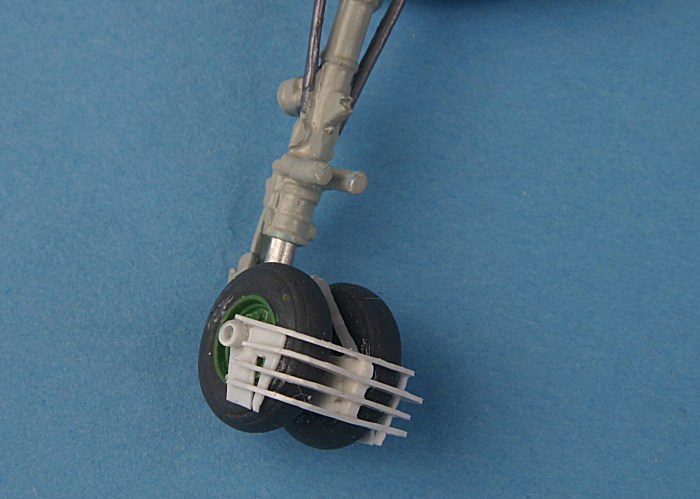

Fabster Posted May 28, 2009 Share Posted May 28, 2009 Oh, Yeah! We can't never have enough Sukhois around here, especially if they are as good as the one you have here, my friend. Thanks for sharing this beauty with us. The right word for me right now is INSPIRATIONAL, no less! Do you have pictures of the scratch building process for the front landing gear (and the rest of the job for that matter) you could share with us? Keep up the good work FAB Quote Link to post Share on other sites
Flankerman Posted May 28, 2009 Share Posted May 28, 2009 Oh, Yeah! We can't never have enough Sukhois around here, especially if they are as good as the one you have here, my friend.Thanks for sharing this beauty with us. The right word for me right now is INSPIRATIONAL, no less! Do you have pictures of the scratch building process for the front landing gear (and the rest of the job for that matter) you could share with us? Keep up the good work FAB I'll let Rom answer with his info, but here's how I di mine in 1:72 scale for my Su-30MKM.... ...and the FOD guard... More on the whole build here. Cheers Ken Quote Link to post Share on other sites
