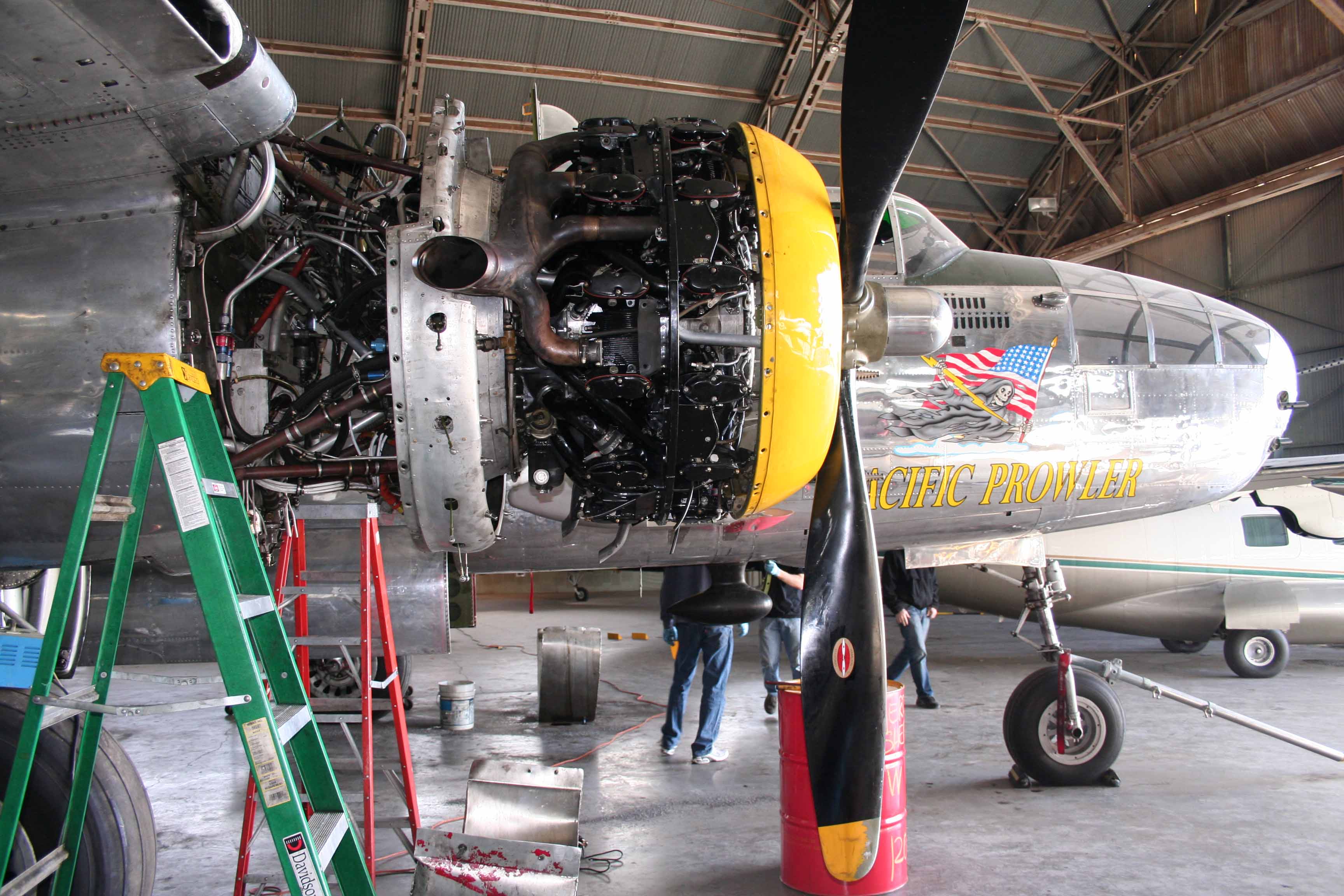

dean spirkoff Posted June 9, 2014 Share Posted June 9, 2014 (edited) trying to show a open cowling on a shot up engine, Being repaired. and a prop being replaced. have made brass and silver engine coils from old phone and cable that will look burnt up. trying a candle. and slowly pulling the wires across the top of the flame. not to low just a little to make the wires looks scorched. then I I even put holes in the prop. my question is dose anyone have pictures of a cowling being removed or being opened and thanks in advance for any help Edited June 9, 2014 by dean spirkoff Quote Link to post Share on other sites

majortomski Posted June 9, 2014 Share Posted June 9, 2014 (edited) Don, the sub line in his title said B-25J. Dean you're just going to have to find a shot of a -25 with the cowling off. It may be different than you think. I work on a DC-3 and the cowling comes off in three large panels, there's nothing left on the engine when the cowling is off. I do know those props use a simple sling to grab two blades and a hoist to lift it off the splined shaft. Good luck on the project. Google image search has this one: http://www.trainweb.org/northtexfreemo/22209B25EngineTB.jpg Oh WOW! I ran this plane back in 1977! http://www.aafgroup.org/galleries/ex-swt-airshow/index.html Edited June 9, 2014 by majortomski Quote Link to post Share on other sites
