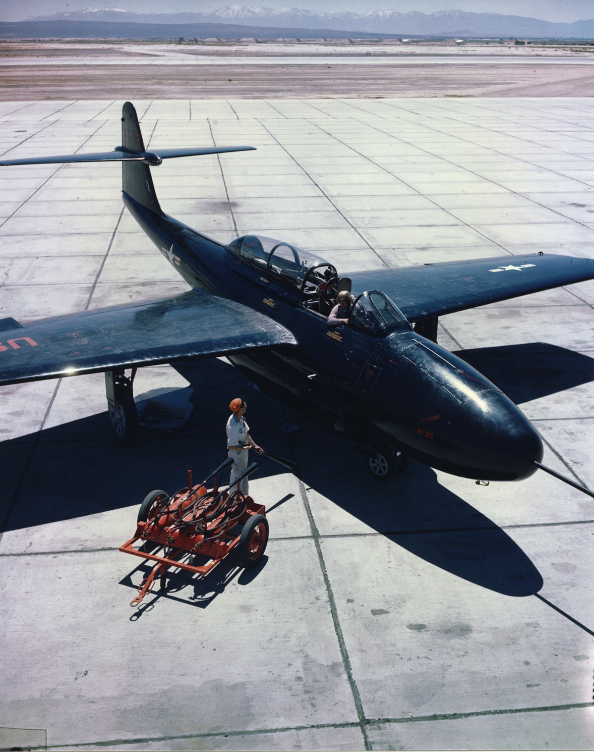

LanceB Posted June 16, 2014 Share Posted June 16, 2014 (edited) Hi Ken, Canopy and windscreen were different. Windscreen was not raked back as much as the production version, making the bow higher. Also, the canopy seems to peak at the middle bow, between the two cockpits, then only very slightly taper down before making a much sharper curve down to the spine behind the aft cockpit. On the production aircraft the peak of the canopy seems to be over or just in front of the pilot's seat, and then the canopy more smoothly tapers back and down to the spine. A lot less headroom for both crew, especially the back seater. Engine nacelles will require some rework, mainly on the open ends. Intake was different, and exhaust end looks less tapered to my eye. Have you this pic? I have a larger and clearer version saved to my confuser, but can't find where I dug it out of at the moment. I would love a large, clear version of the fourth pic down the left-hand side from here (parked, taken from port forward). Hard to get shapes from pics of a glossy black jet! Edited June 16, 2014 by LanceB Quote Link to post Share on other sites
