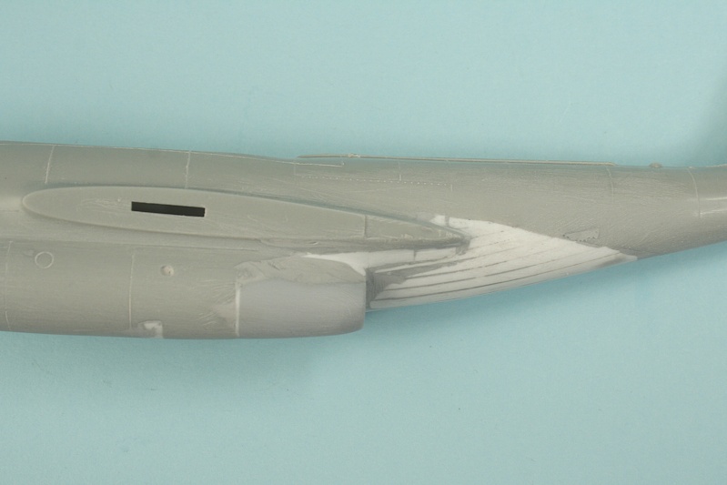

Flankerman Posted June 20, 2014 Author Share Posted June 20, 2014 I have started to add thin strips of plastic card to fill in the rear hole - rather like a clinker-built boat..... I have also filled in the front intake aperture - the intakes on the XF-89 are different.... Trying to get things filled in when the under tray is not fixed in place yet is difficult - but I'm getting there. I also need to cut off the rear of the engine nacelles to fit narrower, more conical, exhausts. Ken Quote Link to post Share on other sites

Flankerman Posted June 22, 2014 Author Share Posted June 22, 2014 The rear of the engine nacelle is totally different to the kit - so I have had to remove the last inch or so and fit bulkheads... .... all a bit 'slash and burn' as I go along - and all done by eye - no subtlety here. I found a plastic knitting needle of approx the right diameter - so cut off the end and sanded it to a curved shape... .... a trial fit shows it to be reasonably correct.... The lower fuselage insert has to be cut down accordingly.... All I need to do now is glue everything in place - and fill in the holes with plastic card.. The exhausts have been reamed out and a suitable piece of brass tube fitted to improve the look... A bit more sanding required to get a smoother curve - but its coming along... Then I have to do the other side, then the intakes, then the nose, then the bullet fairing, then the cockpit, then the canopy..... Ken Quote Link to post Share on other sites

Flankerman Posted July 1, 2014 Author Share Posted July 1, 2014 My computer got hacked - so I've been 'off air' for a week..... While it was being sanitised, I did some more bodging..... The jetpipe is fitted - note the difference in the lower fuselage shape... Making a start on the starboard fuselage - compared to the original at top... For the new, shorter nose, I cut side and plan profiles from thick plastic card - to establish the shape.... ... test fitted in place.... It's all rough and ready - but it works for me..... Meanwhile, back at the rear fuselage.... some more sanding and filling.... I think the shape is almost correct - and the gloss black finish will hide a lot of sins..... Ken Quote Link to post Share on other sites

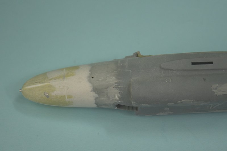

Flankerman Posted July 1, 2014 Author Share Posted July 1, 2014 (edited) After adding a couple more bulkheads and filling the nose with lead shot, I roughly filled it with Milliput..... A few sessions of filling and sanding - and the basic shape is established.... .... more filling and sanding needed yet - but its getting there... I have even had the foresight to fit an aluminium tube to take the nose probe later - not like me at all :woot.gif:/> More anon.... Ken Edited July 1, 2014 by Flankerman Quote Link to post Share on other sites

Flankerman Posted July 1, 2014 Author Share Posted July 1, 2014 After casting around for a suitable diameter tube to make the intakes, I resorted to butchering a 1/700 scale submarine..... Suitable sanded to shape at the front end, they will do nicely.... .... once blended in with filler... The nose shape needs a bit more fettling - but its coming together.... Ken Quote Link to post Share on other sites
